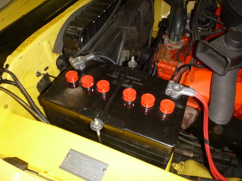

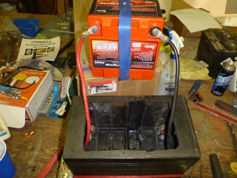

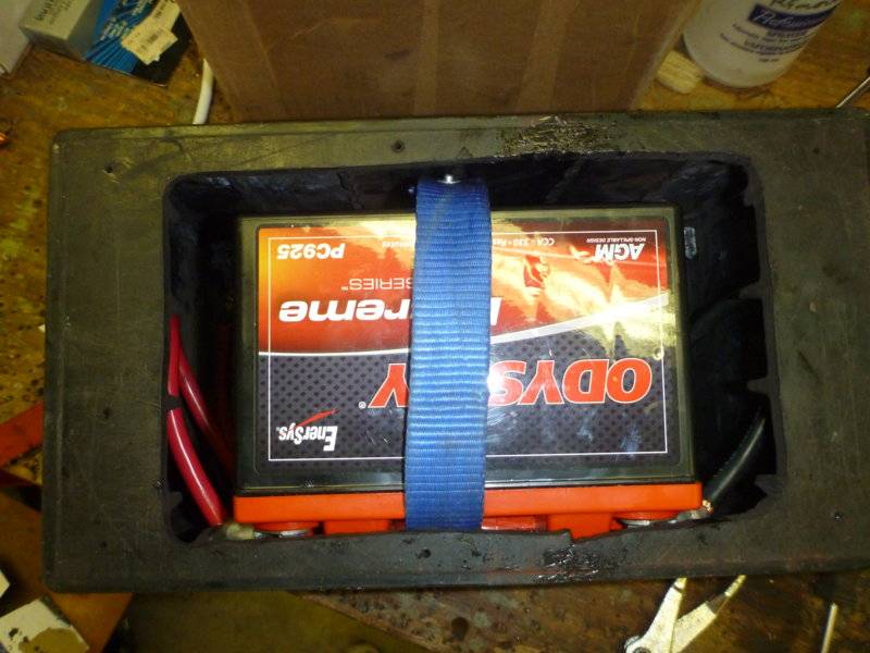

How you make an AGM fit Dennis..
View attachment 862881 View attachment 862882 View attachment 862883
DO NOT trickle charge an AGM. Kill it partially if need be and then hit it pretty hard with 14+ volts to charge at about 8 amps. No need to maintenance charge a good AGM.
