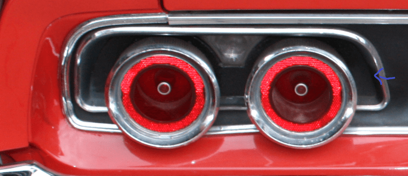

What is correct black paint for 68 Charger Tail-light Housings, what brand of black paint to use. Is it Satin Black or Flat Black
Thanks

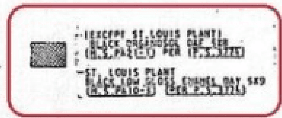

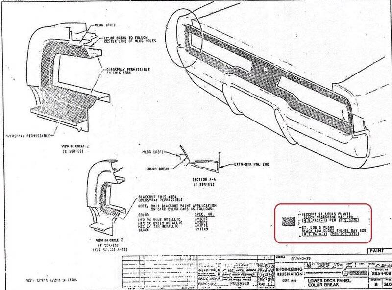

the correct color depends on the plant that the car was built at and on the original color of the car...
And to make the little red box easier to read...
thats for the tail panel,were the actual housings painted the same colour on a 68
Thanks for help
Just need inner tail light black and I already painted my tail panel organosol black
