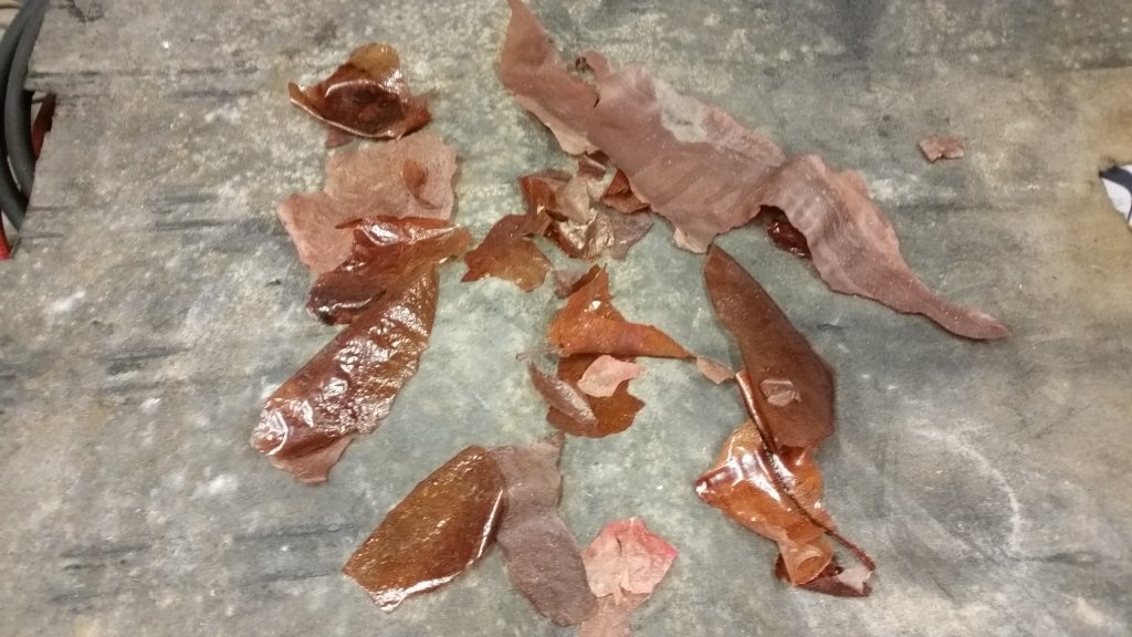

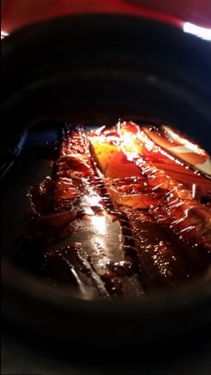

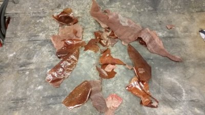

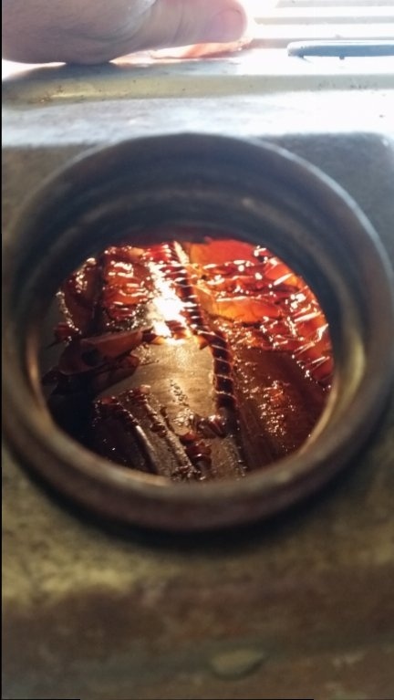

I finally got around to dropping my fuel tank and could not believe what I found in it - loads of what looks like a plastic film - loosely floating about and lots still semi-attached to tank walls. I don't need tarot cards to see a new fuel tank in my immediate future!
What the hell is this stuff? I'm guessing PO poured some goop in the tank and swirled it around to cure a leak perhaps?! -

Maybe it's just old dried up fuel. Is it coming from the sides too or just in the bottom?
Or, someone's half-assed version of some kind of sealer.
What it looks like to me. Anybody heard of a product out there like this? It is all over the inside - top, bottom and sides... there is a real thick chunk of it in a depression just above filler neck orifice and it looks/feels like urethane...

X2 on dried up fuel. spray some oven cleaner in it. wait a few minutes for it to soften up then pressure wash it out. check for leaks.
I looks like tank liner. Do you have gas/ethanol mix in Australia? Some of the liner put in years ago won't stand up to ethanol. If the tank is rusty, it's best just to replace it. I've bought a couple of tanks through Rock Auto, relatively inexpensive.

I'm with those who suggest it is from the gas drying up. It looks like what my dad would call varnish that would build up in and I would clean out of outboard motor carburetors as a kid.

Looks like varnish to me..
