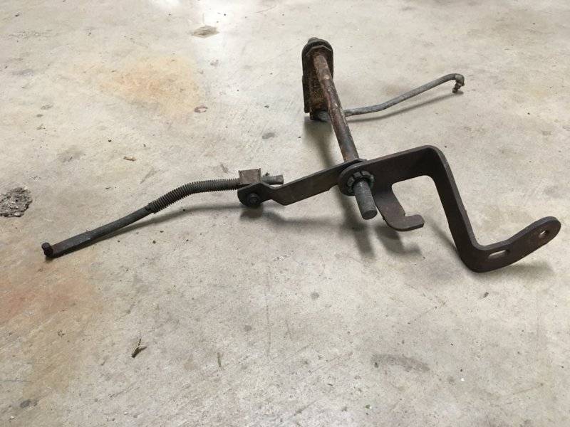

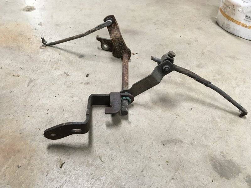

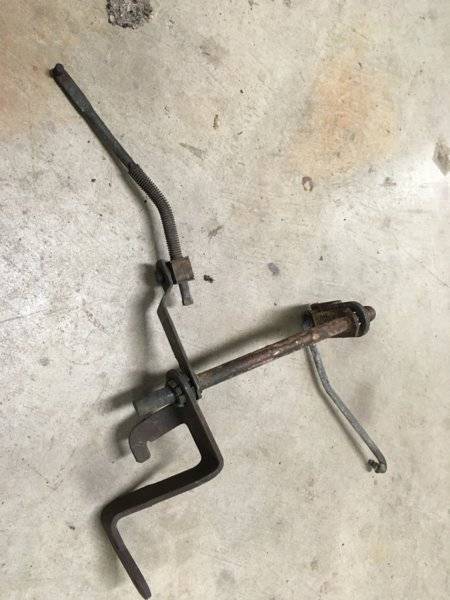

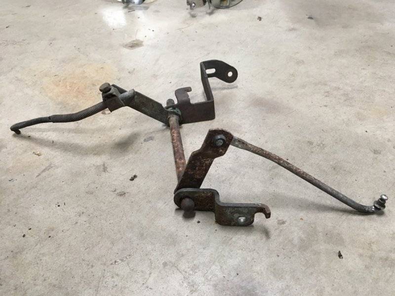

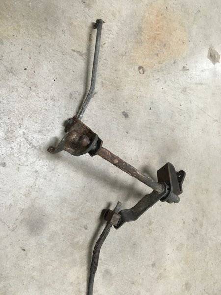

Anybody know what this linkage is for? (More garage cleaning).
(transmission lockout linkage) when you remove the key from the column it locks the transmission

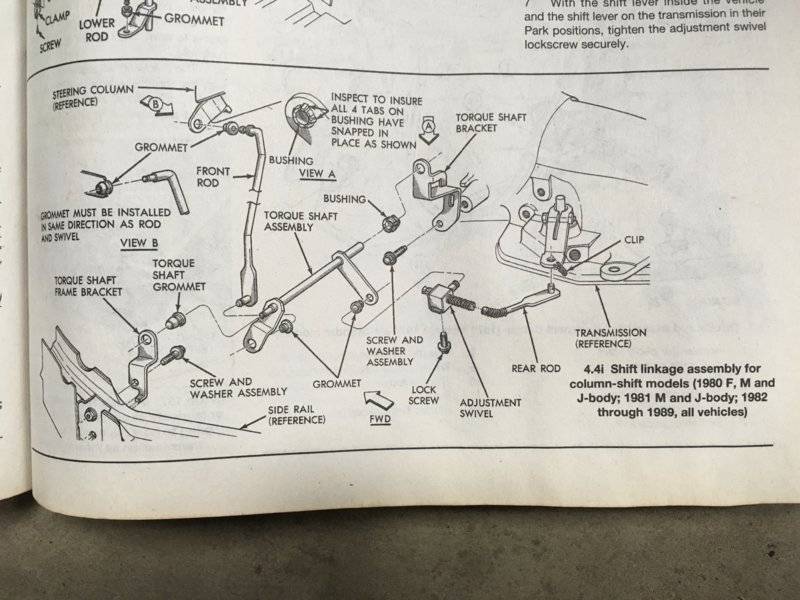

Checked a couple manuals and discovered it came from my 1980 Diplomat. Thanks for the help.
