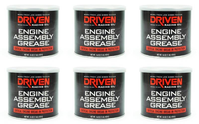

Joe Gibbs Driven Assembly Grease, PN#00728
