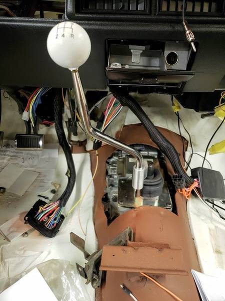

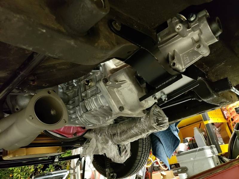

Tunnel Mods
ujc0Qp7xuMRxjB-QZntNOms1PTQhZH2bVqCIGKrJsrW0gKi5foKAEtQyequW15mjoD3sixVrbm_k0L7lP_H=w704-h938-no.jpg
If you don't mind the fab work this ^^^^ is the *******! I've got a few years on my T56 now and absolutely love it. I can run freeway speeds at 2,000 rpm with 4:30 gears, I'm currently running 3:91's and cruise 80mph at 1,800 rpm getting around 19 mpg with a 456 stroker. The gearing 1st-4th is very nice with 5th being perfect for 55-70 mph and 6th being great for 70mph on up. The gearing on the TKO's are also great but they're multi rail shifted whereas the T56 is a single rail shifter... smoother shifting.
I have a thread buried somewhere (viper T56 install) that shows all of the parts and prices for a do it yourself approach. Thinking I had $3,000 in it?
