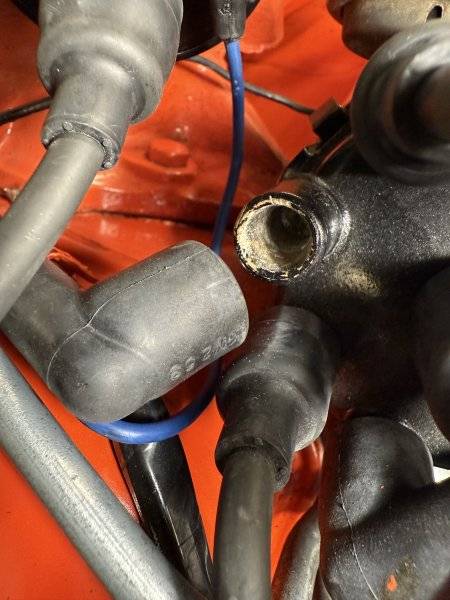

What is the likely corrosion here?
Bleep Bleep
6:31 PM
Aug 4, 2024
453
676
Pittsburgh

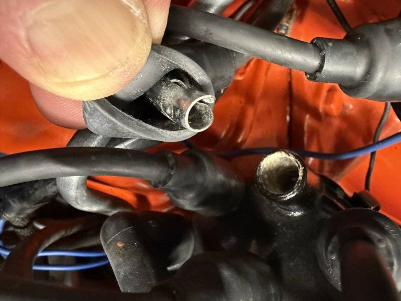

70 Charger. Recent purchase. Plug wire ends and distribution cap shows quite a bit of some colored residue.
Planning on replacing plugs, wires, distributor.
But curious if there are any broader implications elsewhere based on cause?
Just guessing but I imagine moisture got in and corroded the zinc plating. I've seen that before on cars I've worked on. To prevent that, I'd say better quality terminals/distributor cap, and coat with dielectric grease.
Here's Google AI info: (bottom paragraph for zinc coated steel)
