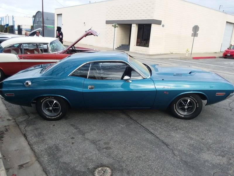

As for 15x7 rallyes on A66 challengers, I don't know. This is what came on my friend's A66, 14x6 I think. (Too small, in my opinion)
Well, if that's an R/T, it's not an A66 car. The A66's were 340 cars that looked just like the R/T's did but didn't have R/T emblems. The A66's were also a mid year car built mainly to get around the high insurance rates that the R/T's had. R/T's were selling pretty good so ChryCo was trying to keep the numbers up by offering the small block (R/T look alike) to people who were having a hard time getting insurance. I also got caught up in that insurance crap. I could afford to buy a new car but couldn't handle the insurance crap so ended up getting a 72 Rallye Pack in 74. My A66 came a year later but it was beat up some but no rust. Also, the A66 cars were supposed to have a little bit bigger front fender opening because of the bigger wheels but haven't confirmed that. I have a question in at an A66 registry and am waiting on a reply. Anyways, I sold my A66 well before any of this stuff became popular and hardly anyone knew about them back in the day.

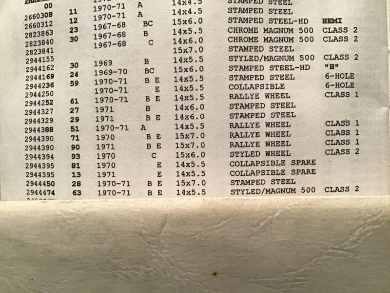

As you know, I owned an original unrestored 1970 GTX with factory trim ring road wheels back in day. I always recalled those wheels as 14x6, but that was a long time ago. So I did some research. Everything you posted is accurate. But I came up with some additional information. I am quoting from the "Charger, Road Runner, & Super Bee Restoration Guide," authored by Paul Herd in 1994. "In 1970, two different sizes of Road Wheels (Magnum 500 were used. Chargers without the heavy-duty suspension option used 14x5-1/2 inch rims, part number 2944474, while rims on the muscle cars were 14x6in, and used part number 3461359." Maybe someone else can verify the 3461359 part number with Chrysler documents. I can't, and of course my car is long gone.

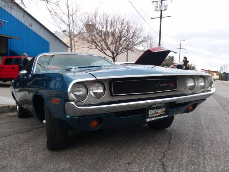

Oh, it's a real A66 all right. My friend has owned it since the early 80s. The previous owner put the stripes and R/T emblems on it. She got dinged by a judge pretty badly for that at a spring fling once, and hasn't shown it at a Mopar show since,
Really a shame, cause I haven't seen a real A66 at a spring or fall fling in about five (maybe more) years.
Edit: she and I have a contest at the spring and fall flings. Which we'll see more of: A66 challenger (hers), real A12, (mine) or Butterscotch paint (also mine) . I never win, cause there's never a real A66.

So Mr R413 it appears I owe you an apology. Did some research in my library and this comes to light.
