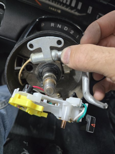

What is this and what does it do?

Because I've snapped it in two pieces. Can I order a new one? Also, where does that white wire lead? Thanks all.

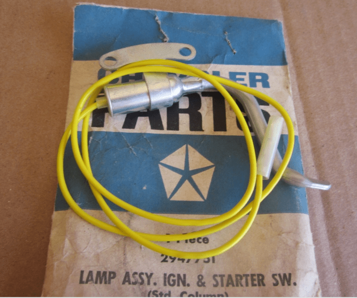

The item pictured is the lamp and optic assembly for illuminating the ignition switch. It connects into the time delay wiring.

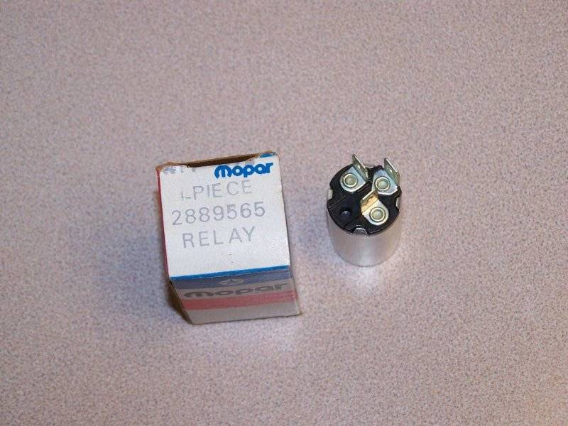

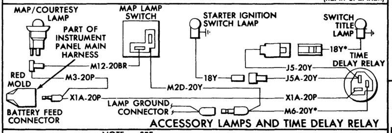

The following images show the lamp assembly, the time delay relay, and the time delay wiring diagram.

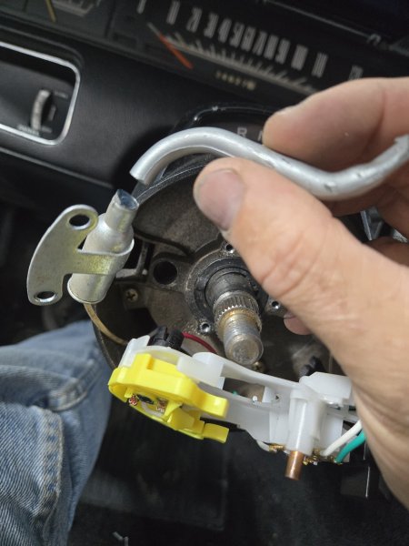

The broken piece is a light pipe. You might be able to glue it together with a transparent epoxy adhesive. The wire color is yellow, but likely faded on yours.
Thank you guys so much. The issue I'm having isn't with that piece, its with my brake lights. When I wiggle the hazard light switch back and forth, the brake lights come on and off, while I'm pressing the brake pedal. So I removed the signal switch to see what's going on and I just barely touched the end of the ignition light and it broke. Im still trying to understand why my brake lights are working intermittently while wiggling the hazard light switch.

The brake lights go through the turn signal switch. Your turn signal switch is going bad.
