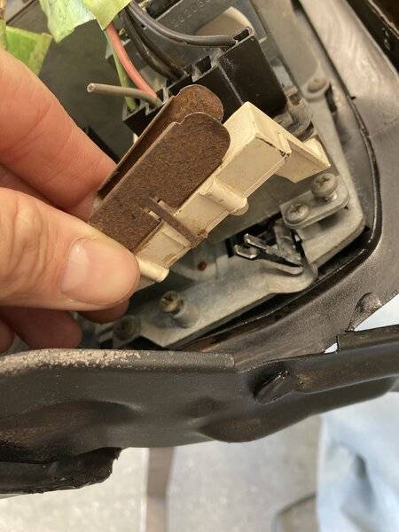

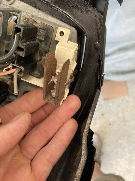

Working on my dash. There’s this piece that screws onto the backside of the headlight switch. Looks like I am missing something here. Any input would help.
Headlight door vacuum switch, why you have one is another question....
Well looks like it’s never been used. Or anything‘s been broken off just kind of there.

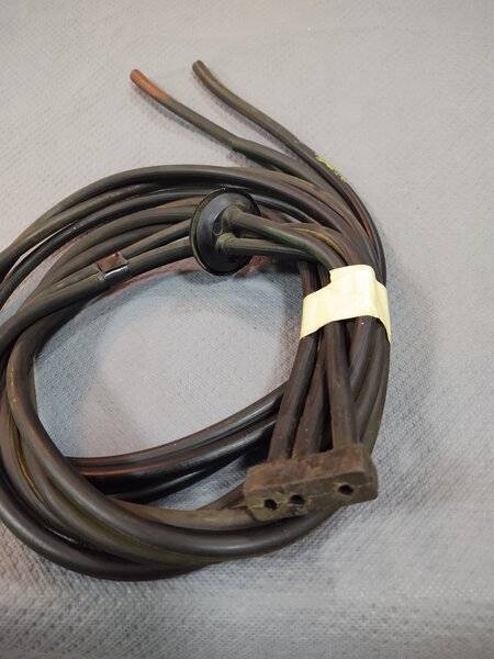

As dadsbee said, that shouldn't be on a Coronet/Super Bee. There's a rectangular rubber "block" with three vacuum lines attached that is held captive by that rusty bracket.
No doubt the cluster had another life in a Charger.

So do regular headlight switches not have the little arm on them to move the vacuum switch back-and-forth? I thought maybe they were all like that and then if you had the vacuum lights you add another piece on.

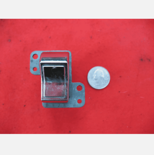

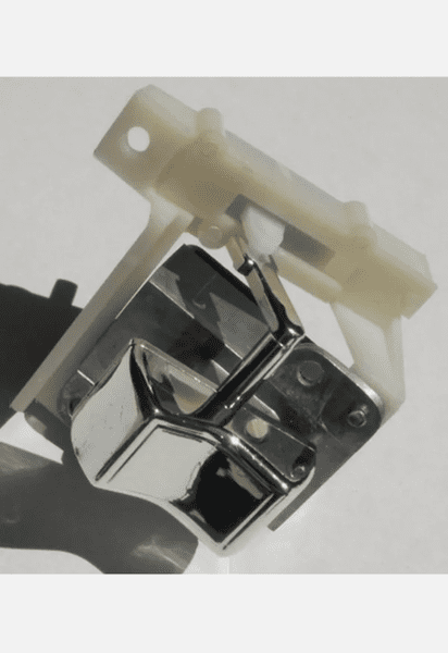

The first picture is what you have and the second picture is what you need. What you need is cheaper, and more readily available.
You are in possession of a headlight switch for a vehicle with vacuum actuated headlights, such as '68/'69 Chargers, '69 Daytonas and '70 Superbirds.
