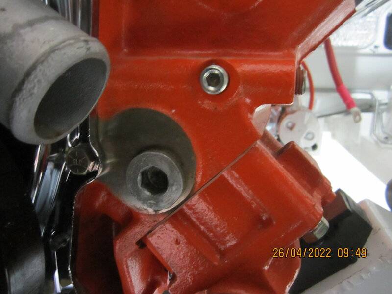

What is the o-ringed big plug for at the front of the block just above the oil pump?
Does that model have a priority main bearing oil galley? Just speculating!
Mike
My MP Hemi and wedge blocks did not have them.
We have a winner!!!! "pnora". Thank you. I have an internal oil pickup now, but may change to external.
