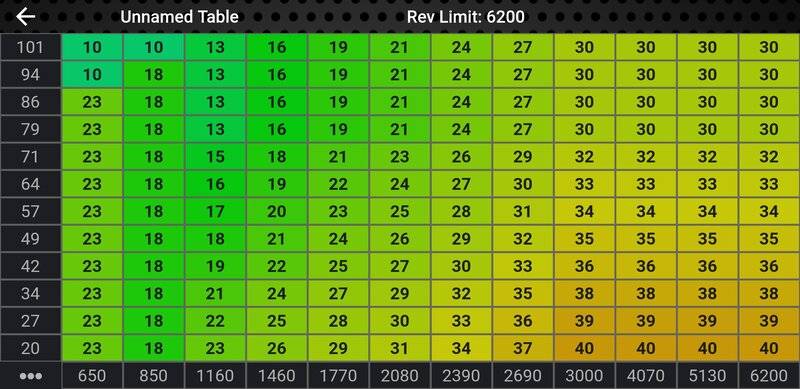

I don't have time to read the manual or tweak the data points, but this is the "map" from the Progression Ignition app.
Download the free app and play around with it.
Now that is some cool stuff there !!!!
I am very happy with mine, tuning capabilities are simple and endless.
The only improvement I could suggest is making it a lil taller for valve cover clearance.

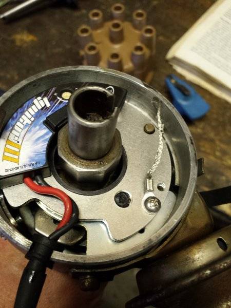

I have the II in my 62 Belvedere and the III in my GTX. The only install difference is that a hall effect sleeve is used over the cam lobe on the II but the III doesn't use the hall effect sleeve. I prefer the III.
