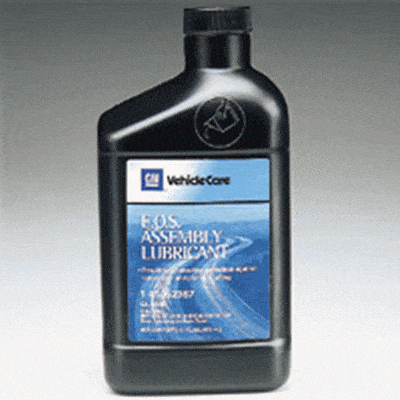

Chevron Delo 400 15W-40 is good oil, has plenty of ZDDP in it. The Rotella T has gone down the tubes unless you put in some additive, I use GM EOS. Those conventional oils (Castrol, Pennzoil, etc, I use no more). I'm switching everything I have over to the Brad Penn oil come spring time. It's pricy at $5 per quart, but well worth it.

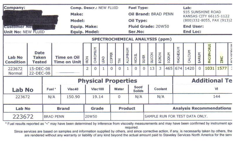

Here is something you may be interested in.I took it upon myself to have an analysis done on the Brad Penn 20/50 racing oil.The results are what I had expected and why I am a firm believer it the product.As I said before,there are oils availiable that you don't need additives.
