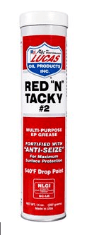

You can use this for anything.
It won't wash off or run.
But it doesn't really penetrate.
And you might need that.
