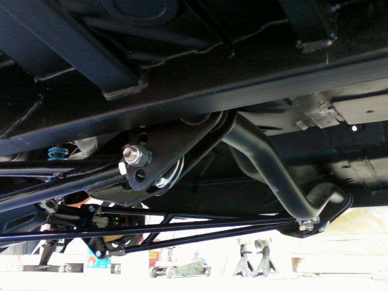

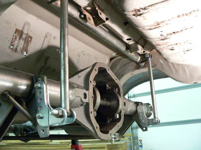

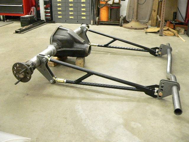

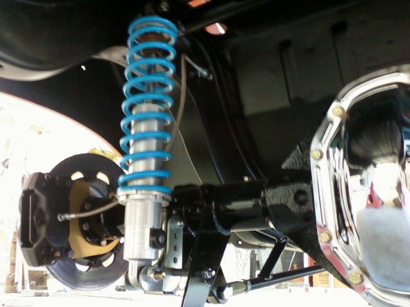

Get "double adjustable". Otherwise they need to be removed to adjust pinion angle. I used S&W . Bought the 36" instead of the common 32" due to the fact that wheelbase is longer than the run of the mill Duster, Cuda , Camaro, ETC. 634 passes. No issue with the product at all. I'd buy the best double adjustable shock you can afford. Use 120LB springs on the shocks.

View attachment 940426 View attachment 940429 View attachment 940430 View attachment 940428

I bought the good Chrome Moly rod ends. Same ones 634 passes. No play in them.

View attachment 940426 View attachment 940429 View attachment 940430 View attachment 940428dvw, did you buy it as a kit or piece that together with s&w
