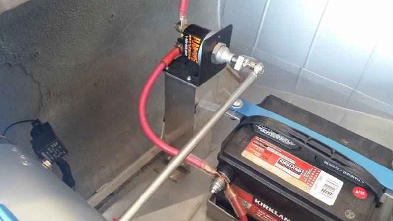

I have a Flaming River unit too. Don't recall the part number, but it is the one with the aluminum rod remote shutoff.
Just looked it up, same as cudatom, #1003-2

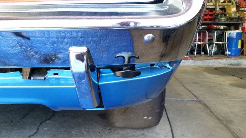

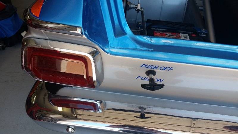

I have the flaming River on my car. Nothing I hate worse is when someone goes through their tail light lense or in their tail panel with the on/off switch. So, I made a custom mount and have it between my bumper and rear valance.
I went through my bumper where there was already a hole from a trailer hitch I removed
