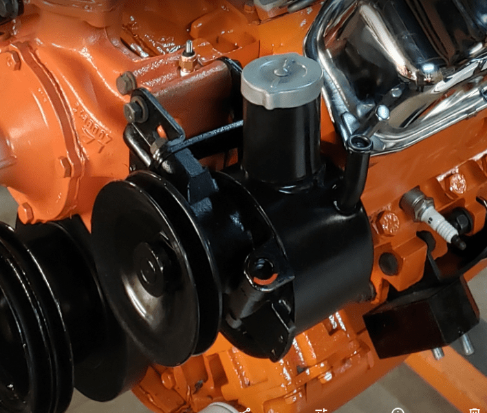

What PS Pump would have come on my '65 Coronet 500 273/TQ?
I am installing a later model 318/4 speed.
This car did not come with a pump or hoses...
If you only need a PS pump to provide pressure, use a Saginaw pump as that is what later models came with and brackets are available to mount them.
Mike
Mike
Sounds reasonable.
I needed to be sure there wasn't a huge pressure difference or an issue matching hoses between the two brands of pumps.
I have an older 1960 Federal (iirc) pump from a Chrysler but I may even have a Saginaw in my pile of crap.
We will see.
Thank you.
Came on a 1964 car. Was sent out and rebuilt. No leaks or issues but I should have went with a Firm Feel box.
