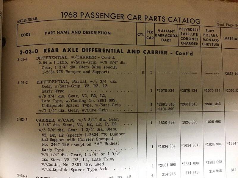

742 was a small production window in between the 741 and the 489.
IIRC 68/69 only. 70 and up got 489's.

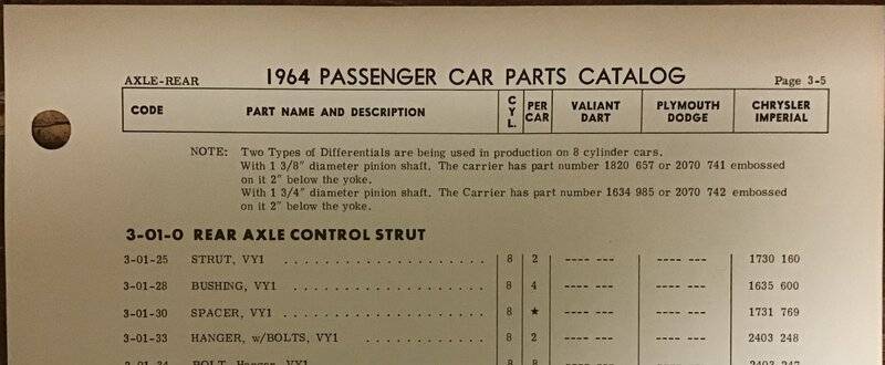

The 985 case was used from the late 50s to the mid 60s. The 742 case was used from 1960ish to 1968. They both used the 1 3/4" pinion. The 489 was first used in 1969. The 657 and 741 cases both used a 1 3/8"pinion. A 426 4 speed would probably use a large pinion setup.

It appears someone was quoting Max Wedge, not street wedge, numbers.
489 case appears late 1968. See intro notes in 68 parts book page 3-1 and reference to 489 case in 3-03-3.
