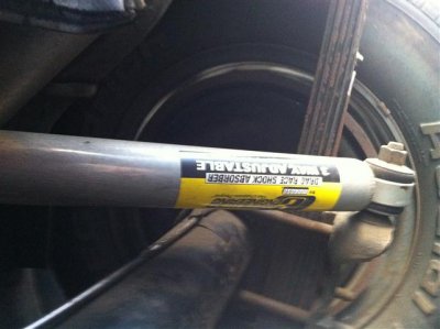

I use these on my 69 RR with SS springs.

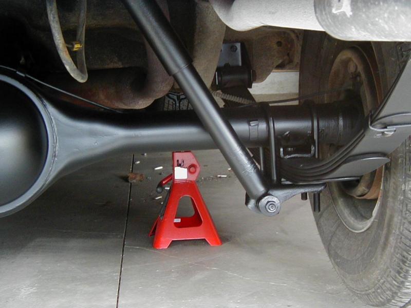

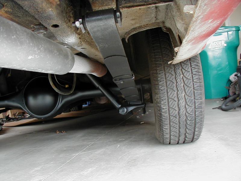

I am running SS springs on my 63 Dodge so I went through the same thing.
