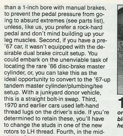

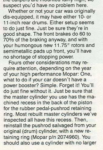

These are from Mopar Action disc brake conversion about master cylinders.
