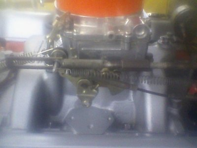

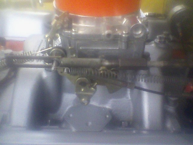

no , you dont. bolt it on and go. i am using my original 2bbl throttle cable bracket. you will need to extend your kickdown rod or find one for a 4 bbl, and make sure its set-up properly.

Did you just saw the end off and put in that barrel nut as a turnbuckle?

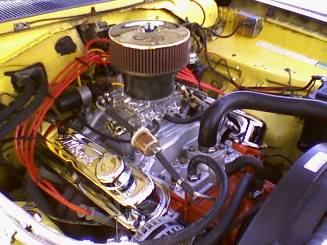

Nice lookin engine bay.
I LOVE seeing what the car's body color looks like right next to the engine color.
One of my favorite things about our cars.
its actually just the threaded type KD arm, so i added the barrel nut and a couple inches of all-thread. it worked perfect. thats what seperates the mopars from everything else is the body color bays. love em'
