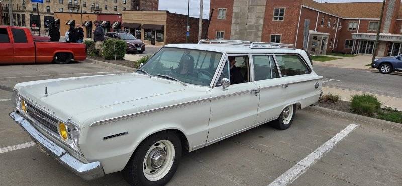

After trying some 245 55 15s on the back I decided I didn’t care for the smaller diameter thin sidewall look on this wagon. So I ended up putting a set of 225 70 15s on all four corners, they are close to the same height as the original 8.25 14s and nearly as wide as the existing 235 60s. Anyway the 12 year old tires are gone and we’re cruising with confidence after recalibrating the speedometer with a 31 tooth gear
