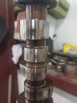

So I posted a while back that my motor started making a hack of a racket, It only has about 30-45 minutes of idle/ reading time irn it.
I pulled the motor a couple of weeks ago and started tearing down the top end and this past weekend tore the bottom apart.
I had figured it was the idler gear axle grinding on the block but when I removed the cover found that the cam button was missing and the cam had walked forward allowing the bolts to grind against the cover sending aluminum about the engine.
The brand new pump had aluminum embedded in the walls of oil pump eccentric. The cam bearings are toast yet the journals look fine as do the hydraulic roller lifters, the cam lobes show some wear on the edge of the lobes, I assume from the cam moving off center.
When I pulled all of the rod caps they (bearings) all showed some slight,( very slight), wear, the weird part was that the journals & mains look brand new. The rocker shafts and rocker bushing showed no marring either. Pistons and walls look freshly machined.
I was pushing out a piston and my F.I.L. dropped the piston and broke the top ring, no damage to the piston as I had laid a layer of cardboard under the motor while I disassembled.
The motor is a 440, pretty stout, 10.5cr, eddy 84cc heads, KB236- .010, cam is a Hughes H-Roller 555/548-246/252-110°LSA. Crank has already been turned .010
So my question.is do I just have it boiled, new cam bearings installed? Of course new rod and main bearings. Does anyone polish cams? I would hate to have to purchase a new one.I do have a new unopened new XE275HL K kit sitting in the cabinet but seemed a little tame for what I wanted if the cam is toast, but I need someone else to look at it and advise on its condition.
Should I have the block re-decked? Are my Cometic head gaskets worthless now or can they be reused?
Also should I replace all the rings? Or can I source a single somewhere?
Thanks in advance!

Start from scratch, boil out, new cam bearings, new cam. No need to machine anything (deck) that is good. I've gotten individual rings from Mancini in the past. Make sure EVERYTHING is clean, metal & debris-free.
Ya the cleanliness is going to be priority. I need to find, if they still make it, Varsol. I've been using mineral spirits but it doesn't seem to clean as good.
The reason journals weren't hurt is it was aluminum not iron going through the engine... The bearings are soft so they take damage, the pistons are a tougher grade of aluminum so they probably didn't get any embedded debris.... However being they are Hyperutectic & not forged I'd be concerned about the one that got dropped.... That something that could come back & bite ya... Single pistons are available... If your lucky the cardboard softened the hit butttt....The cam can be polished...
Having seen a few engine with metal pumped through them I'd disassemble every lifter, every rocker arm, take the plugs out of the ends of the rocker shafts, flush everything... When you think it's spotless do it again... White paper towels need to stay white....
Take the block, crank, oil pan, rods & pistons to a machine shop to get washed in the jetwash. No need to "boil" it out, if anyone actually even does that anymore. Most of us use a jetwash (Industrial Dishwasher) anymore due to the amount of aluminum engine parts today. Remove the pipe plugs to ensure the oil galleys are cleaned out properly. Also, have the machine shop replace the cam bearings. The cam lobes are flat and not tapered due to being a roller cam. If the lifter rollers look okay and have no damage, and the cam lobes look ok and not damaged, I would reuse it. I wouldn't worry about the edges of the lobes as the lifter rollers should run in the middle for the most part. If you are unsure, the machine shop can evaluate it, or just replace the cam & lifters. I would also replace the oil pump pick-up tube as it can be very difficult to totally clean it out. I don't think I would trust the new parts and motor on a $30 to $50 dollar pick-up tube. You can get a single piston ring set for half or so of a new set of rings usually. If the machine shop uses a ball hone, I would deglaze the cylinder you are installing the new rings on. Use one complete ring set (top, 2nd, oil) on the piston. No need to re-deck the block, and while some of us have discussed this in another thread, I would not reuse the head gaskets, and get new ones, but others here will disagree. It is YOUR motor so YOU need to decide if you want to take the heads off for a third time or not. And, yes (thanks 1W R/T), disassemble the lifters to clean them out and the rocker shafts too.

If the cam is smooth, and you can't feel any ridges with your fingernail when scratching from
front to rear, you'll be O.K. No discoloration, (heat). You can polish the cam yourself with 1000
grit wet-or-dry paper and some light oil. Clean, Clean, Clean! Ditch the cam button!
I'd further inspect the cam, mic the lobes across their width.. if they're flat and not coned or rolled over I'd reuse it. You didn't happen to notice how the piston landed did you? On cardboard if it wasn't mashed flat and still had some cushioning and the piston landed on it's side or top I probably wouldn't worry but if it landed on the skirt?? I wouldn't reuse the gaskets, if you really want to I'd at least give them a call and see what they say. Definitely just buy a single ring.. no biggie there. As has been mentioned cleaning is the most important thing then inspecting everything thoroughly prior to reassembling it. My question would be how did the button come out in the first place? They should have a very minimal amount clearance making it impossible to fall out, last one I installed fit tight and well deep enough that there's no way it could escape.

You may know more than me on this but aren't cam buttons recommended on roller cams? On a traditional cam the action of the cam spinning the lifters keeps it in check but with roller lifters the cam can walk outward which it obviously did?
I'm really not sure, it was a nylon button that I had to reshape due to the bolts, basically had to shape it into a triangle due to the washer head interfering and shortened the total depth to get the .010 clearance from the cover. I do remeber that it wasn't a really tight fit and that I was able to push it in to the sprocket easily.

I've seen you post about not using a cam button before... Sorry this is proof that you need one... IF the cam didn't walk forward the bolts would not have make contact with the front cover.... Flat tappets I agree no need for a button... Roller cam = button... I know you think the oil pump drive gear takes care of it.... Well Chevies have an oil pump drive gear too yet you feel they need a cam button..... Hmmm...

It is as simple as this; a flat tappet block without provisions for a roller setup (fixing lifters and a cam thrust plate) WILL require a cam button. This pretty much covers ALL big block Mopars. GM engines are the same, an early Gen 1 SBC block will require link roller lifters (link prevents rotation) and a retro-fit roller cam to allow use of the early flat tappet timing set, AND a cam button. A Gen2 SBC has the provisions to be roller so all you have to get is a roller install kit.
You might not think so, but the roller cam CAN walk in the block, and needs either a thrust place or cam button to prevent this. The distributor will not prevent the cam from walking, and when it does, the timing will change as the cam moves out. And I will leave you with this one extra point, if it is supposedly impossible for a roller cam to walk, then why does the OEM use a thrust plate, cam button, and sometimes both??
