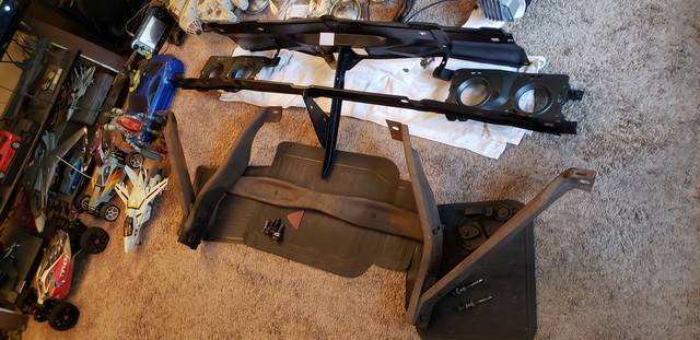

Hey folks,
The can of worms I've opened with removing the grille and the grille support on my '69 Charger has opened a little bit more and now I've removed the bumper brackets. They're structurally sound, don't look bent and have just a little bit of surface rust and grime so I wanted to clean them up and spray them with some sort of black and get them back onto the car. What's the best way to do that?
Would it be enough to just take a wire brush and/or a grinder with a wire brush attachment to the brackets, take off the loose rust and then just shoot it with primer and paint? That's what I did with my grille support and I'm satisfied with the result.
Another question: what are the two bolt holes in the center portion of the bumper bracket assembly for? I don't recall anything being bolted to those holes.
Also, when I removed the brackets it looks like one of the four bolts is the wrong bolt. Can I just buy that one bolt somewhere? All I see are sets of the complete four and I'd rather not buy them all if I don't have to. But, something tells me I can't run to NAPA or Home Depot and find these things either. Thanks in advance!
