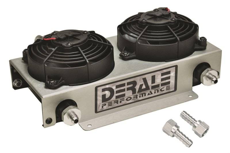

Derale cooler with fans 10amp draw, like $159+ (sure thyue went up some) at Summit Racing

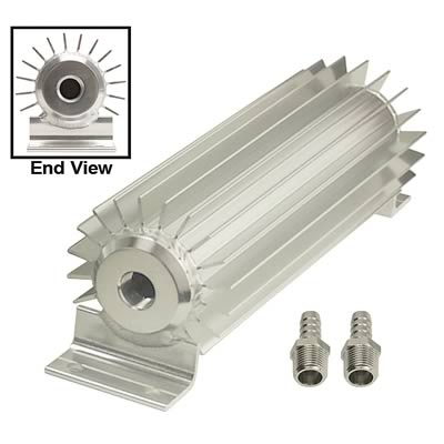

like this one from Summit racing for like $59
Transmission Derale Heat Sink Trans cooler der-13249_w $57.95 Summit Racing.jpg
