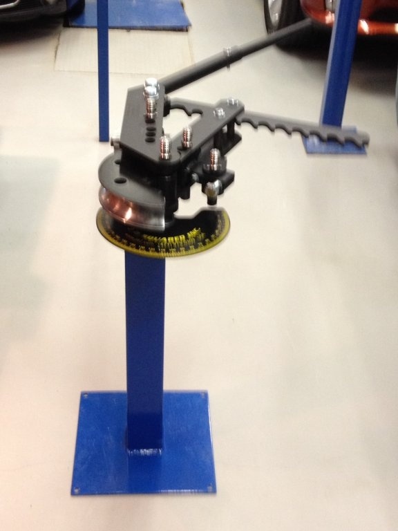

If your just doing it once in a while. The Woodward fab works great. Just up grade to the 180 dies. You can add a hydraulic ram from harbor freight. I'll send some pics.

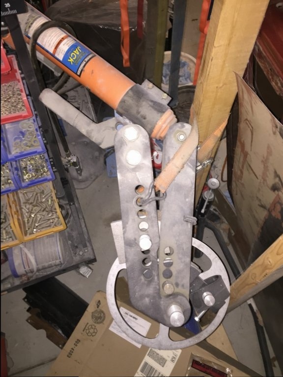

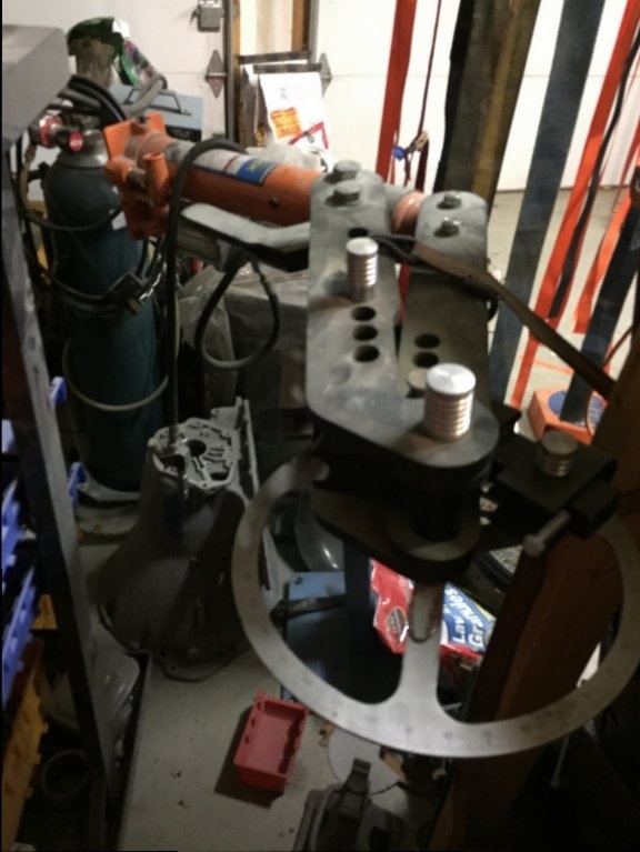

My JD2 model 3 has the SWAG offroad conversion clamp for the harbor freight air over hydraulic cylinder and all my dies are 180 degree and most will go a little more. There are lots of pics in my superbird thread.

Very nice! The air over hydraulic was the way to go for me in a crowded shop with floor heat. No drilling and no need to have the bender confined to one location. My shop is so full, I've had to let the bender move while bending because the long tube couldn't!
