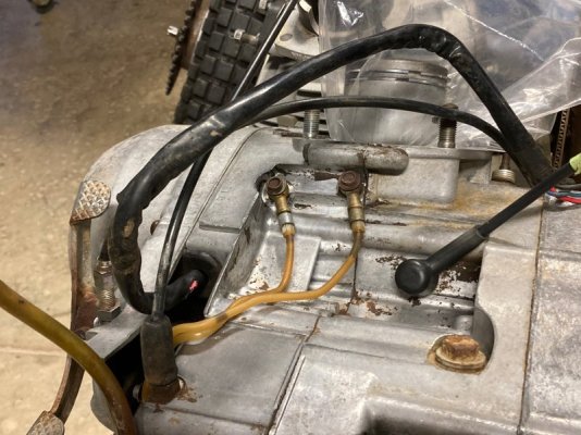

I found a vid on U tube from a guy who has been building/restoring two stroke bikes for years talking about whether or not to ditch the oil pump on Suzukis and Yamahas. He worked at a Suzuki dealership many years ago. He had both Suzuki and Yamaha 125 engines split and was able to show how both oiling systems worked. The Yam has case holes drilled to move oil/gas mixture below the cylinder straight to the crank bearings for lubrication purpose. So, to block off the single line from oil pump to intake and run pre mix , no problem. But the Suzuki does not have that at all. Right side crank bearing pulls lube in from tranny oil and keep it lubed. But, left side crank bearing has a separate line coming from oil pump to keep it lubed. To by pass the oil pump on them is to shut off oiling to the bearing. It can be modified by splitting the cases, drilling a feeder line to that bearing in the case from below the cylinder. Then, machine off a blocking lip off both the crank and crank bearing and installing that amount shim on the left side. He says some bikes have run a long time when bypassing the oil pump and NOT doing the mod, but , that is the way they did it at the dealership back in the day. I think for me it's best to keep the pump working as designed. Thanks guys....

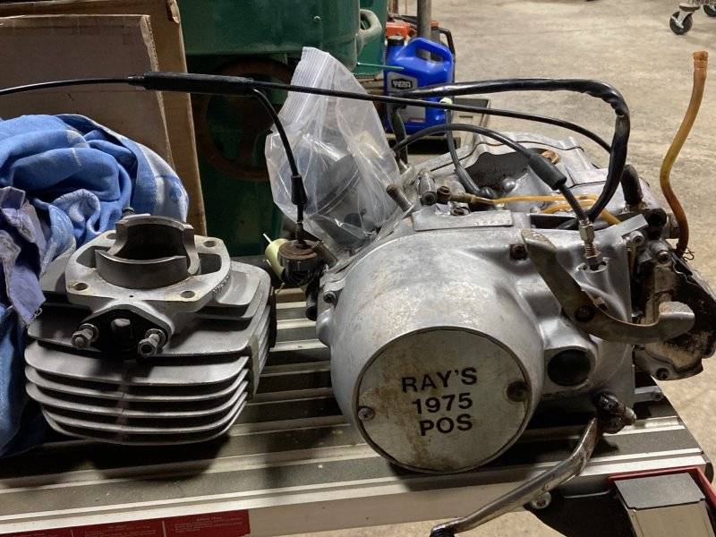

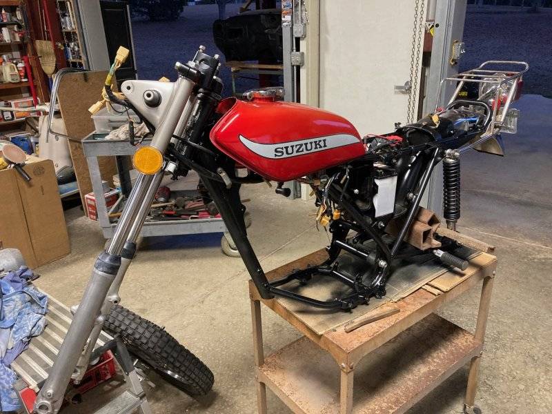

I used yamalube and Klotz back in the day. any pics? of these bikes
IMG_0609.jpgIMG_0610.jpgIMG_0611.jpgThe Suzuki going back together. I pulled the cylinder off to fix a broken exhaust stud and it just went downhill from there. Now thinking of pulling the side covers and replace all the seals and gaskets. As you can see , Ray, the first owner, liked this bike so much he needed to stencil on the side cover his true feeling about the bike. Note the dual oil feed lines.
