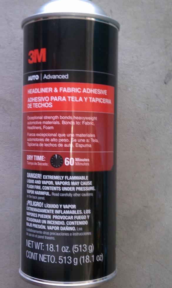

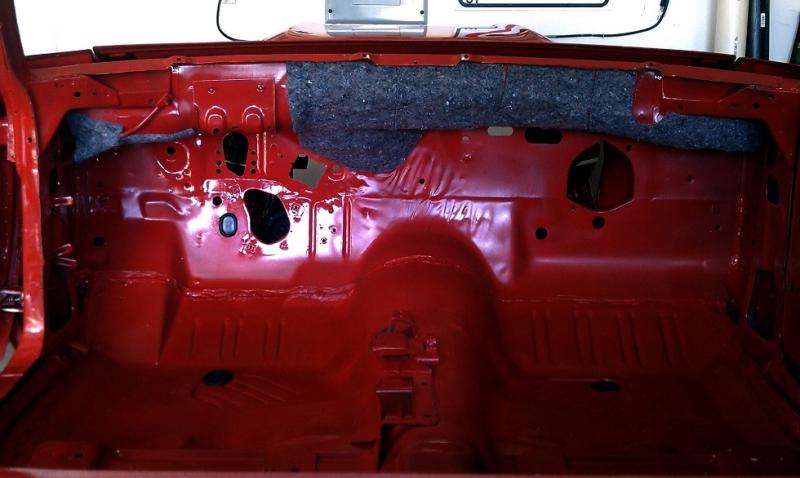

Success, got the shoddy pad installed today, Thanks to Purplepeeper, went to autozone, found Carpet and Fabric adhesive, works great, pictured below, that pad will not be going any where for a long time. One thing i did, as you might see on the drivers side is the pad goes over the support bar there, which is how it was when i stripped the car, its not correct, but what was done at the factory, so i decided to keep it the same, instead of going under the bar.
