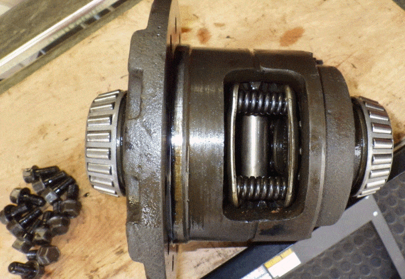

Is that a 9 1/4? If so, it sure doesn't look like the one in my Durango....
Out of my old Trailduster. Think they changed up around '82 or so.
Page 3-19 thru 3-24 of the '77 Ramcharger Trailduster service manual.
Looks like a 2 piece carrier/case in the pic. Never worked on the early 9 1/4 but the newer ones use a 1 piece case and it's a pita to put new clutches in them unless you have the right tools...

Yeah Bill, it's a 9-1/4" LS out of my old Trailduster that I had a short while. Picked the truck up with a wasted 440 for parts from a good friend. He told me the LS had 2 years on the dealer rebuild.
Asking 80 plus shipping from 60506 (paypal). If one has a service manual, possibly some proficient online coaching help, and some good mechanical ability, I'm sure one could handle it.

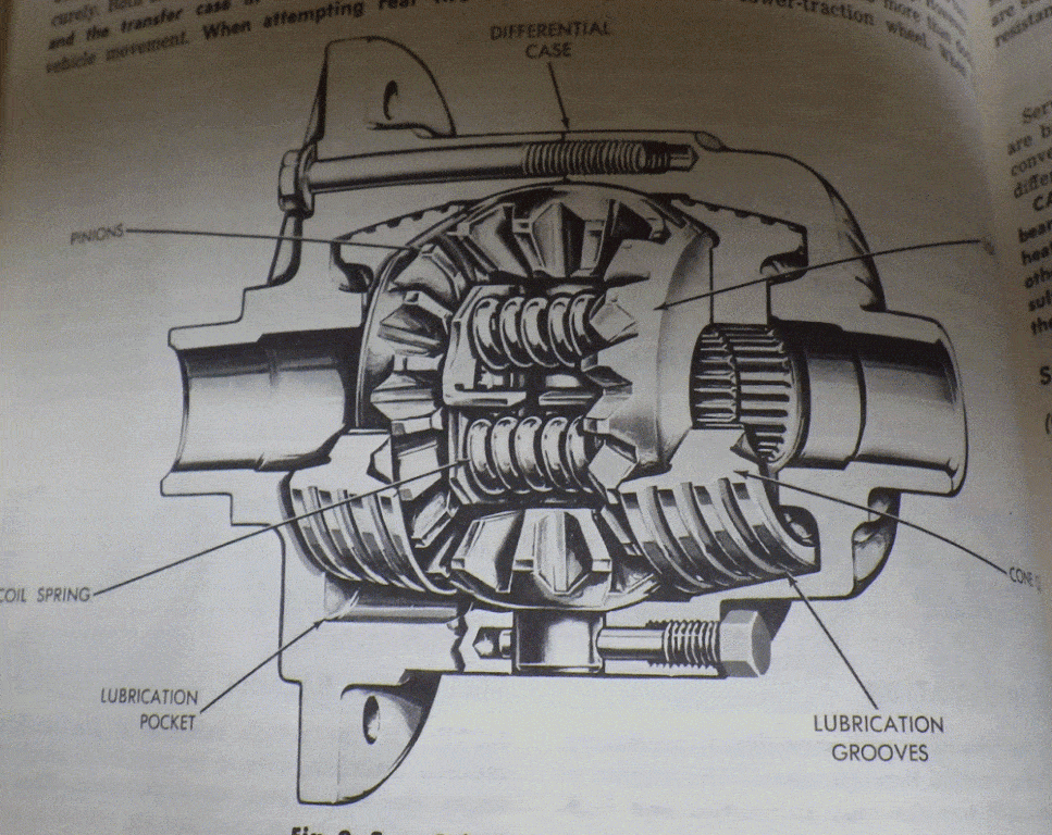

Here is a sketch from the SM of the older one........
My '05 has the corporate LS with the clutches in it. Evidently there has been problems with the clutch pack retaining clips breaking up and locking the gears in these. They have not recalled them for this as far as I know but have recalled for loose pinion nut. Took it in earlier this year for the nut.
