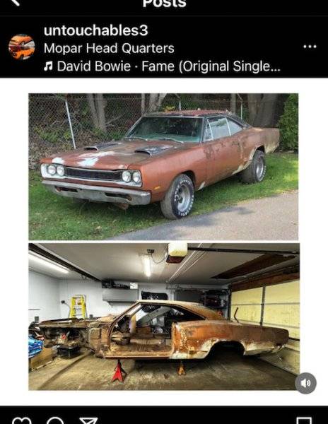

I have my Dad's 69 4 speed 383 Super Bee that needs a complete restoration. I recently picked up a 69 4 door coronet and other than the obvious things such as front clip stuff such as fenders, grill headlight bezels, trunk, bumpers, front and rear brakes. I wanted to know if the body wire harness could be used? I know there would be a difference from 4 door pins vs 2 but what else is different? What else could I use? Floors, frame rails, trunk floor? I saw a thread that said what works and what doesn't but it was for a 66/67 satellite. Not sure if that was for other 2/4 door cars as well. Thanks for any input. My picture is before disassemble and current.
