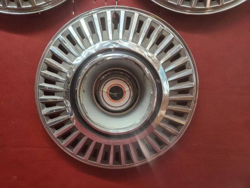

Does anyone have a picture of what the hemi full wheel covers look like?
I'm just curious.
Very similar to this.
Different center cap
My former 69 hemi had these when new
Just different center cap I believe.

Black wheels came on black cars and cars with full wheel covers, A12's and some spare tires such as cars with full covers and road wheels other optional wheels but most of that was in 14"
High school classmate's family had the same on a new Chrysler Newport in 1968. Assume the center caps changed between divisions.
Correct, the cover itself is the exact same. Just different plastic center caps depending on the application its being used for , used on..

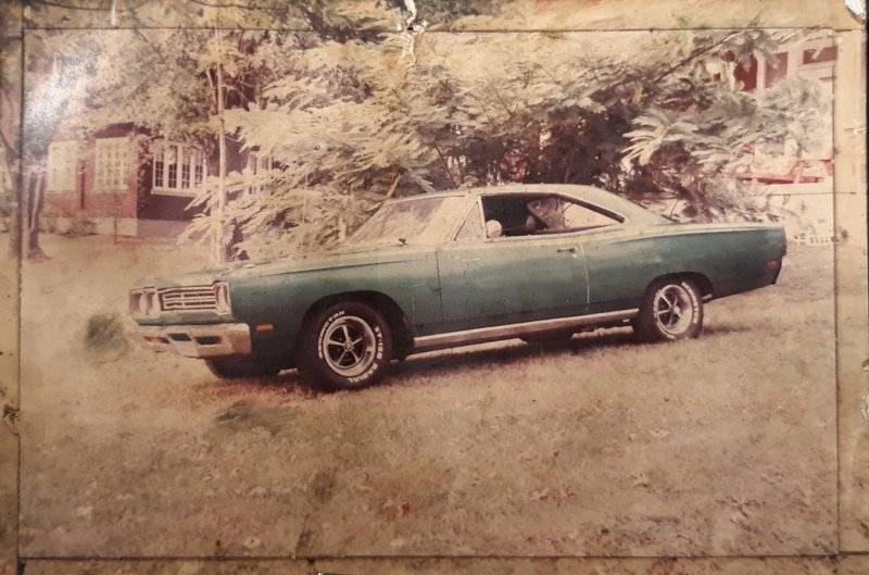

My old car was equipped as such. I went to the family of the original owner a few years after I bought the car. ( original owner had passed away several years earlier ) And the full wheel covers were still hanging on the garage wall.
I was told they were only on the car maybe a few months when the 1st owner put a set of deep dish Cragers on it .,,which were still on it when I got the car in the early 80s btw
When I sold the car the covers went with it. But no idea if the man ever put them on the car.
The car as pictured a few years after I sold it and still running the same 14 inch road wheels I had on the car ( yes I know hemi cars were all 15 inch, but these were all I had at the time.)
So I ran them

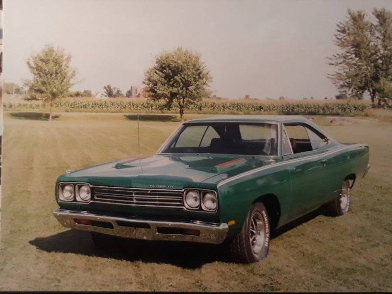

Now I'm wondering what roadrunner's had a rocker molding?
Never noticed some have it.
Is this part of the A87 decor group?
Nope. My 69 rr has A87, but no rocker moldings (option for RM21 coupes only)
