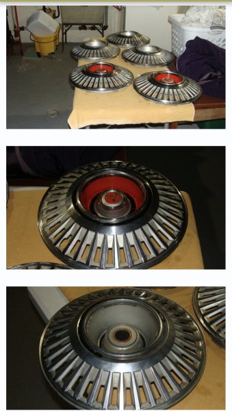

I bought these today.
Looks like 3 of the 5 have the correct centers for a hemi car.
