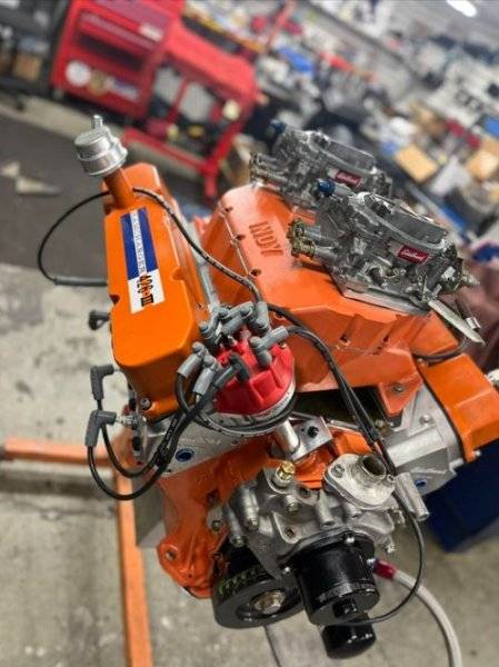

This thread has been quiet for a while because the motor has been in the machine shop getting rebuilt. It is supposed to go to the dyno tomorrow. Accepting guesses for power level. Here is the spec:
512" RB 440 source kit with lightweight crank
12.5:1 compression
Edelbrock Victor heads
Indy 440-25 intake
dual eddy 750 carbs
Comp cams solid roller 660 intake/682 exhaust 260 duration intake 272 exhaust

Results are in from the dyno. 653HP/650TQ. I was hoping for a bit more, but this is a good start. My cam may be a bit small now. I do not have all the specs yet. I will be picking the motor up at the shop on Friday. The only change to the motor was pistons to get from 10.5 to 12.5:1 compression. Cam, heads, intake, carbs, etc are unchanged.
