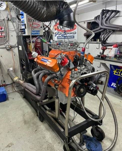

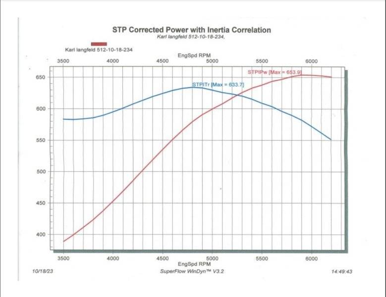

Where were the peaks?
Was it run with the race car headers?
If not, do you know what size headers were used?
I have not seen the dyno sheet yet. I will get that tomorrow when I pick up the motor. Here is a pick of the motor on the dyno that shows the header that were used.

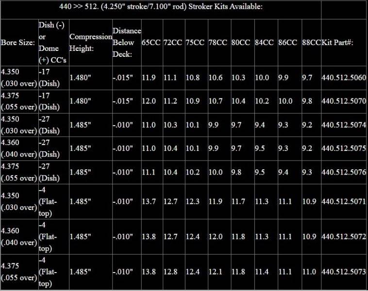

I ran a compression check on the cylinders. All came back between 148 and 152. I was expecting higher.
I have another compression gauge in my truck right now that I borrowed from a friend. We will see what it makes with this gauge.I’m not saying you don’t have 12.7cr.
I’m just pointing out the cranking pressure numbers don’t make sense.
