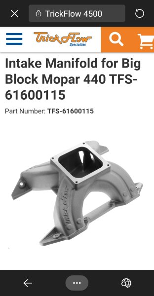

I know at the track the ET and MPH are what matter, and I hope to have a track car one day, but I'd be less than candid if I said I wouldn't be really happy about it being able to run on the street some, and my point is that 440-25 looks like it may have a fatter and fairly high torque curve compared with a straight from the carb to the heads intake like the Super Victor or the TrickFlow MW for a 4500 carb.
