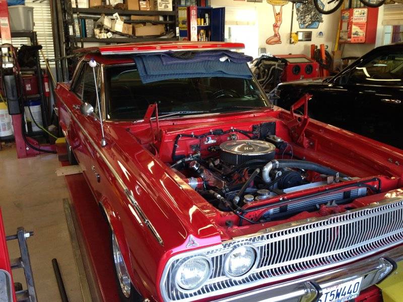

My 440 had a Torker, 850dp and a Holley filter unit on it. Fit under the hood with no issue. Filter unit was a drop base too.

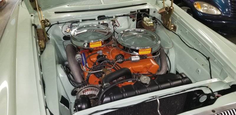

If you really want a Max Wedge setup it can be done, minus some hood bracing.
Look carefully at what's been done to the hood.
