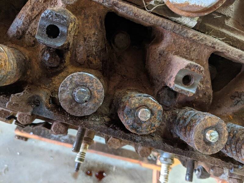

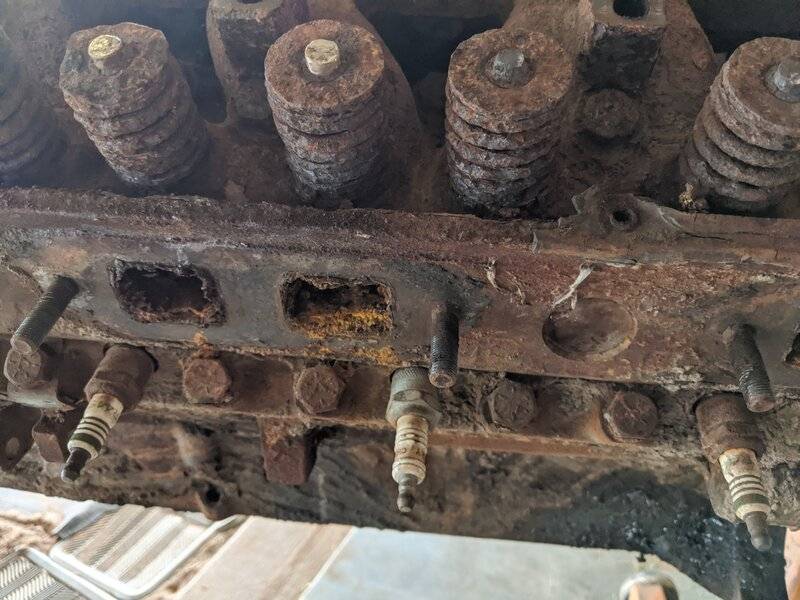

73 400 2V nothing special. Sat outside with no cover and the valley pan rusted out. This is the second one I've had like this.
Allot of work to get the cast crank out.
Heads are toast. Heads bolt are going to have to cut off.
Cylinder condition unknown but guaranteed to be rusty.
Is it even worth the time trying to take anything out of it? Looks like scrap iron to me.
Continue to tear it down. See what it looks like in the bare block form. One thing is for sure. Its a seasoned block now.

If it's a thick main web block (230 casting?) it still has value, especially if it can go .030 over. I'd strip it and at least look at it bare. (A 630 casting can have the thick main webs too. Only way to tell however is to look.... without the crank in the way. A230/630 400 block is the strongest oem b/rb block made )

A friend of mine put a engine block as rusty as yours into a blue 55 gallon plastic drum in a solution of 9 parts water to 1 part molasses for 3 or 4 weeks. And was amazed how clean the block was after pressure washing it.

I voted to scrap it....it's toast !
