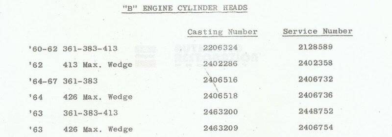

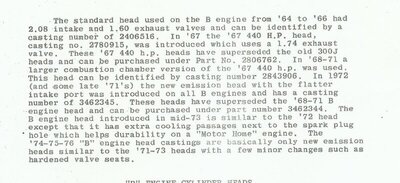

I don't believe it is one of the good 230s? Due to date. But I believe a thicker cylinder wall 630 is possible? If so? Give it a try, and clean up the block.We don't know at this point, he hasn't posted casting numbers. But, if it is a thick main 230 or 630, it could be the strongest oem b/rb block Mopar ever made. The '73 date means it could be. He won't know anything about it till he gets the crank and pistons out.
