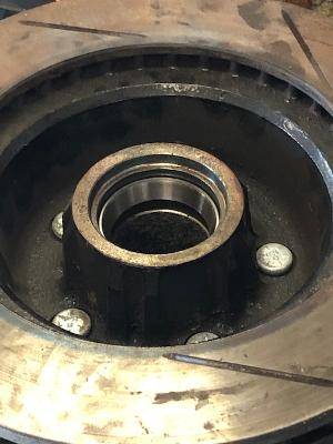

I have a 12" rotor that had a few defects in the inner bearing race. I decided to replace the race along with the bearing.

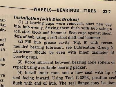

The race is below the edge by about 1/4". I wasn't sure of how deep that it was supposed to be so I checked the service manual.
They call the race a CUP and state to drive it flush with the hub.

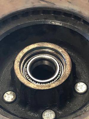

Strange though....
The old one was in about 1/4", I have 4 other rotors here that look to be set about the same.
The bearing in place....I'm curious about how deep the race is actually supposed to be. The FSM states to be flush, the rotors I have are not the same year as my FSM....The rotors are the 1973 and later style.
I guess I could slip it all together and see if it works, right?
Drive the race in till it is hard against the step/shoulder... If you don't it will find it's way there on it's own, likely destroying the bearings & possibly the spindle and/or rotor at the same time...
They usually have a landing to seat on.
I thought so but the hard step is another 3/8" or so in further. It seems strange.
My best guess on the confusing text.
(Assuming you have the proper race/bearing set.)
The FSM is usually a one size fits all on this type of thing.
Covering more than one type of car.
Alternative theory which may be more likely?
"Drive flush" is a first step.
Meaning it's not cocked.
"Seat cups against shoulder" is the final step.
And lastly if all else fails, the FSMs of the era is not know to be a beacon of clarity.

The FMS picture posted says to use a soft steel block to drive the cup flush. (That's so the cup is started straight) Then you use a soft drift to drive it down further to the shoulder inside the hub.
