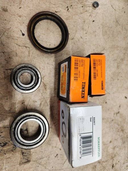

Only posting with intent to help. My 68 Coronet RT has an SSBC disc brake kit installed on the front from a previous owner. The company seems to boast about being made in USA but my car had Chinese bearings in it that failed.
Digging I found the Timken Set2 and Set6 are direct fits. This is bearing and race set for those not familiar. I ended up using a Shaeffler SS2977 wheel bearing seal.
Rudy
The SSBC used the stock knuckle (aka spindle by most) so yes the bearing numbers are just that of stock replacement. The seal number is good info for folks using that kit as they would likely be specific to their rotor/hub.
