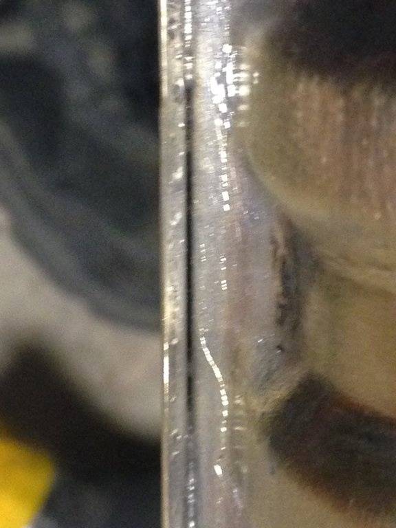

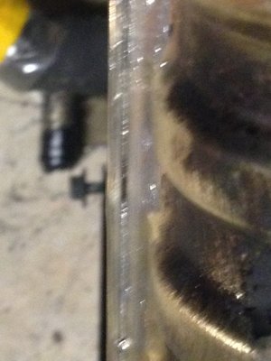

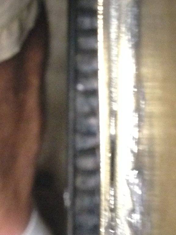

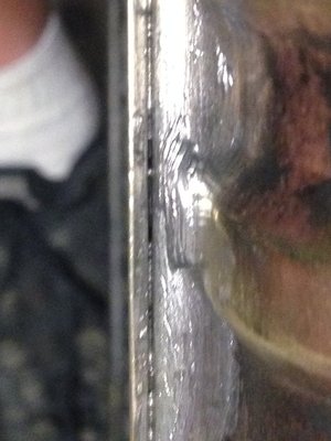

I do not believe its a crack. Only the solder has come loose. He may even get away with just a reflow. the pictues below are where i overheated the tank on the RX7 radiator and had to chase the damn leak all around. I was trying to use flux core. Thats where i messed up.

I soldered it this morning with acid core repair solder. It isn't pretty but it's holding water. We'll see what happens when I pressure test it.
I laid the rx7 radiator on its back capped off the lower outlet. Put gallon of water or so in it. Used a spray can top from I think it was PAM "Wife wasn't too happy" drilled a hole in it big enough for my air gun to poke through. And put some pressure on it to check for leaks.
