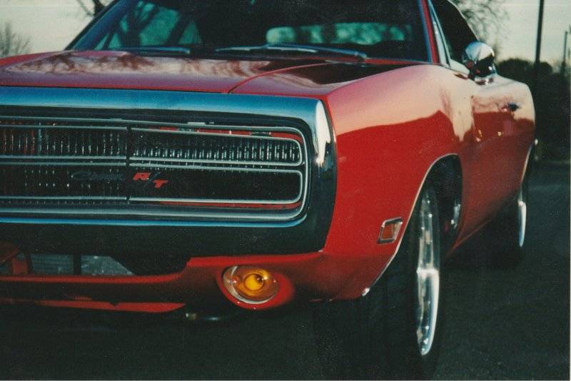

My first version of this 440 with the 4.15" crank turned 369 HP at 5400 rpms.
It had 10.8 compression, the MP 509 cam, Edelbrock heads with stock rocker arms, an Edelbrock Performer RPM intake, Demon 850 carb, 2" headers and electronic ignition. I had a 3000 stall converter in the 727 and 4.10 gears. I sure thought my rear wheel HP would be more than 369. Even if you add 25% to that to account for "gross HP at the crank, I would have still been below 1 HP per inch. I hear that many people are disappointed with their dyno results.
Who knows where I am now with lower compression and a bigger cam.
