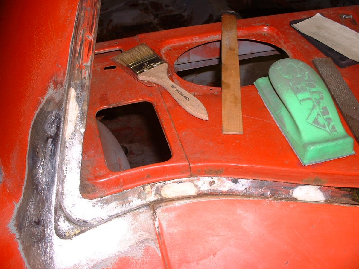

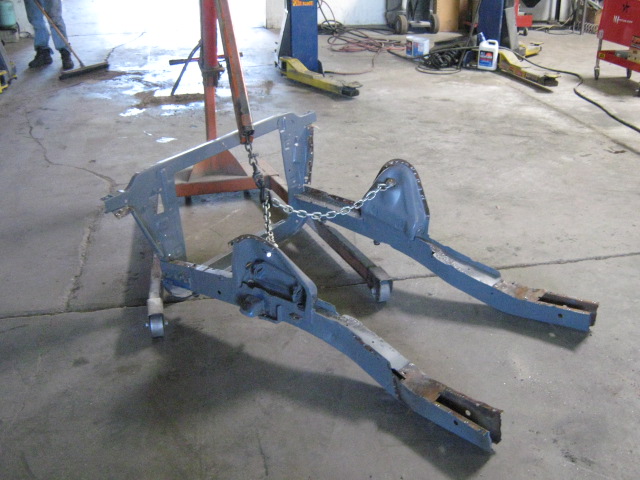

70 gtx
This week I got the cowl cover off and the replacement fitted.
Then I drilled about 200 MORE spot welds and removed the front framerails and radiator shroud.
Monday I will weld the replacement rails in. I got a front "clip" with good rails and shroud attached but the rear cross member was swiss cheese. We tacked a piece of 2x2 between the rails before removing it so we could maintain the spacing. I also welded an XV Motorsports front rail frame stiffener under the radiator to stiffen the front end of the rails.
