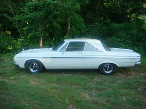

Yeah, the 66 and 67s are really tight. I have had 69 and 70 model B bodys, and the wide wheels are not an issue. I am thinking 15x7 on my 67 Coronet R/T. But am also wanting to do the wheels on my 64 Fury. Wondering if 15x8 rears will work on that...

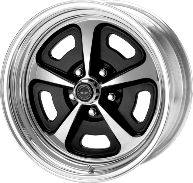

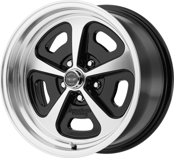

I'm looking for 15" wheels to upgrade my 14" Magnum 500's too. I was looking at American Racing VN500 and 501. The 500 is a 2 piece design and looks better I reckon with more detail to the rim. The 501 is mono cast (1 piece) and weighs about 22 lbs less per wheel. I love the idea of the weight saving but I'm not sold on the looks.

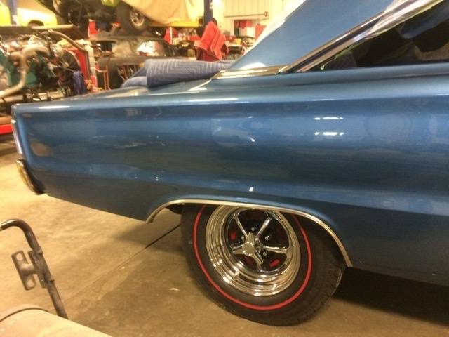

Have 15x 8s on my 66 Satty.
Right side is a little tight getting on and off.
Other than that,no problem

15x8s should be no problem on a 64 fury, IF you have the right backspace. 4 1/2" b.s. seems to be the golden choice. Do your own measurements.

Lighter, about 1/3 the price of the two piece, with the proper backspace for a stock fitment, the one piece are a no-brainer!
