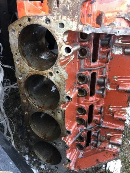

Now here’s a thought…. Start with a 400. If you can afford a stroker kit go to 500 cause it fits nice without having to modify a bunch of stuff. Otherwise pistons to get to 10 or 10.5 to 1. Brodix raised port cylinder heads, roller cam and tada… a big block that breaths awesome and headers fit the same as a rb block but you have a b block.
I have a 400 I want to build like that and eventually put in my charger. Then I can say it’s a 383 with heads no one will be the wiser other then if someone reads this thread.
