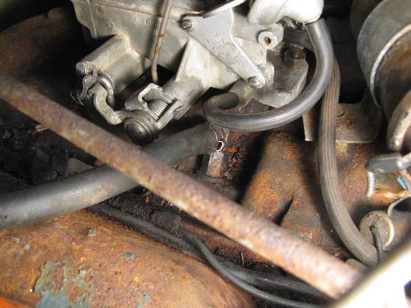

I've got a '66 383 4-bbl and there is a rubber hose that goes from a fitting at the intake manifold mounting flange to a port at the back of the engine next to the oil pressure sender. Below are a few photos. The first is showing the rubber hose fastened to a fitting next to the oil sender (the hose goes over the ground wire and the white wire). The hose is crimped with a factory-type band.
The second photo is where the hose connects to a fitting that is in place of an intake mounting bolt. You can see it under the vacuum line to the carb. This end of the hose is also fastened with the same type of crimp clamp.
Here is a close-up of the fitting and clamp:
I'm stumped as to what the hose is for. At the moment it is cut in the middle and has a plastic vacuum hose type of fitting clamped into place. I'm presuming oil flows from the rear of the engine block and dumps into the manifold fitting (and back to the crankcase) but am baffled as to what it's purpose was. There may have been something plumbed in the middle of the hose at one time. Anyone seen this type of thing before?

Thanks for the replies guys. The front fitting is where an intake bolt would normally go, so the fitting is doing double duty as an oil fitting and an intake bolt. Someone had mentioned to me that the intake manifold bolt holes just 'daylight' into the interior of the head, so any oil running through this strange oil line just gets recycled to the engine sump.

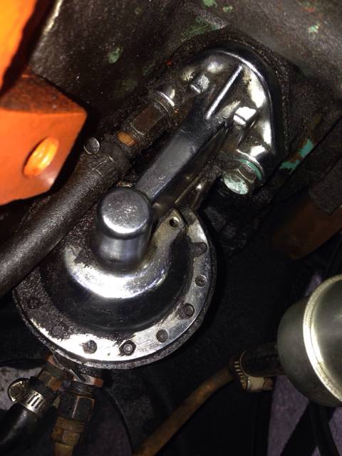

My Charger still had one installed when I brought it home a few months ago:
It picked up in the same place as the OP's, coming from a brass adaptor under the oil sender.
it dumped back into block through the left bolt hole for the fuel pump:
