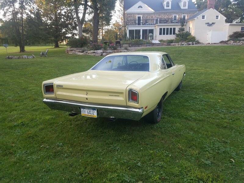

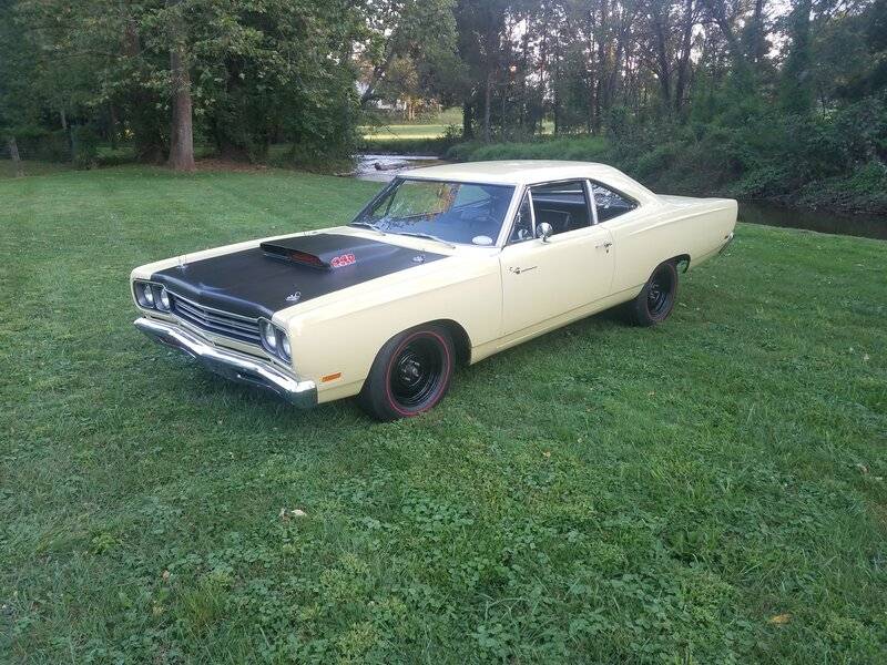

Coker or Ebay you can find redline radials. I know Firestone are not correct for A12s but i like a radial to drive and it doesnt lose the bias look
I would DEFINITELY buy my redlines from Diamondback Tire. The Hemi cars had F70x15 in 69, the Sixpack a12s had G70x15 Goodyear redlines (only!). Every other B in 69 had a 14" wheel.
G70x15 would be a 225/70x15 today.
The A12 needs bias or the 'bias look' radial redline. Any traditional radial even redline stands out big time. I guess cause of the plain black wheel your eyes go right to tire
