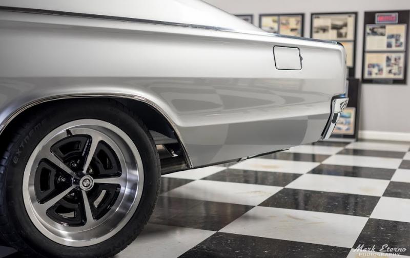

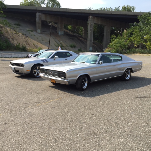

Agree with your hypothesis. The original setup on the first generation chargers can be improved by better filling out the wheel well. Not sure if the pictures help but trying to illustrate with a picture. Used different tires, rims and ultimately a spacer to arrive at the set up in the picture. Had to go with 17" tires due to the brakes.
If you were just using a billit spacer to adjust back space it might be ok. Those style adapters are known to break. My rec is DON"T use them.
I have towed many ricers and a few 4x4's with broken adapters.
That is exactly what I am looking for, are they Crager 500's? Can you give me the full spec of wheels, tyres, spacers as I wish to copy that look 100% if you don't mind! :)
Wheels are Magnum 500s from YearOne
Front 17 x 8 inches
Rear 17 x 9 inches
Tires
Front 245/40ZR-17
Rear 285/40ZR-17
1 inch spacer in the rear.
Sorry, I don't remember the backspacing and the car is at the restoration shop storage and a little tweaks (just finished car in September) so I can't measure it. Hopefully the pictures help.
