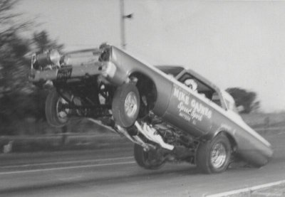

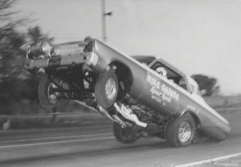

20110624_65.jpgAlter the rear wheelbase 15", move the front wheels 10" forward (with a tube front axle) and set the engine back 26", put your 440 on Hilborn Fuel Injection with 70 per cent Nitromethane mix and you will carry the front wheels for the full 1/8 mile, guaranteed. I did it in 1968.

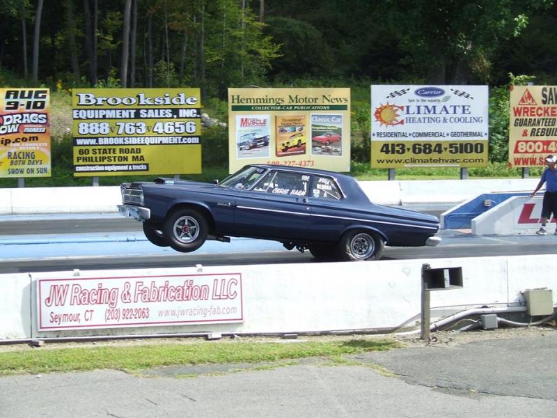

Or...in today's world get yourself a 500" motor making a minimum of 600HP, Cal Trac 90/10 front shocks, Cal Trac 9 way Adjustable RR shocks, Cal Trac bars, Cal Trac mono leaf rear springs and a good set of slicks and you will pull the front wheels, guaranteed. I did this last week Best Wheels Up.jpg

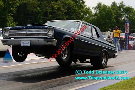

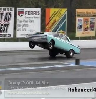

A good set of front and rear shocks,A working rear suspension Loose frontend and gobs of torque equals this
