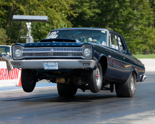

I agree. That's why I always beat SSR!

As stated already. Gear, converter, good tire preferably slicks, loose front shock setting, and for a little bit more... build a couple of 100 pound weight bars and put them in the trunk as far rearward as you can get them, this will help.
Watch the fast (4.0-4.5@1/8) drag radial cars. The wheels are seldom more than 1" off the ground on a good pass.

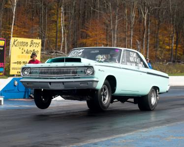

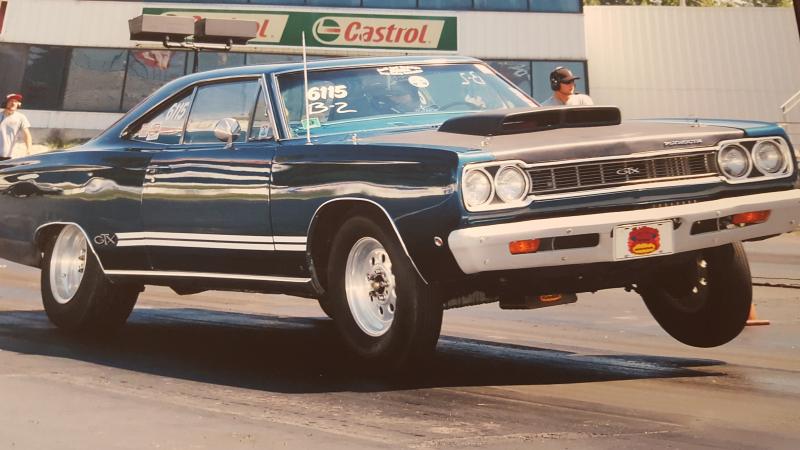

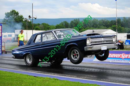

Bobtile is not lying. These big wheels stands cost me a bunch of wins last year. Wheelies for me are a thing of the past.
1 to 2 feet maximum for me now.
AS I like to go fast and going up slowed me down .08-.1
Took me a long time to figure out where my ET went. I was chasing everything but the obvious.
